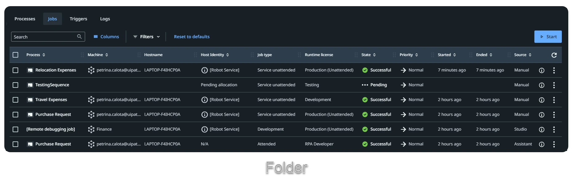

The Jobs page represents the jobs control center, where you can monitor launched jobs, view their details and logs, and stop/kill/resume/restart a job.
The table below contains field descriptions for the Jobs page.
Field Description
Process
The name of the process.
[Remote debugging job] is displayed for jobs started from Studio through remote debugging sessions.
Machine
The machine object used for connecting the executing infrastructure to Orchestrator.
Hostname
The name of the workstation used for execution.
Host identity
The identity under which the execution takes place. The following values are possible:
  • <Domain\Username> - jobs executed under that specific account. Displayed in the following cases:
    • foreground jobs regardless of the Robot version;
    • all jobs executed on Robots lower than 2021.10;
    • attended jobs executed on robots connected using a machine key, without user sign-in.
ⓘ For Robots older than 2021.10, the host identity gets populated dynamically according to the account settings made in Orchestrator. Changing the domain\username for the account used to execute a job changes the host identity as well.
  • ROOT - background jobs executed on Linux robots.
  • NT AUTHORITY\LOCAL SERVICE - jobs executed under the Robot service identity. Displayed for background jobs executed on Robots 2021.10+ without credentials.
    ⓘ Service mode robots run under NT AUTHORITY\LOCAL SERVICE. User mode robots run under a certain user identity.
  • N/A - jobs started from the Assistant by users connected using interactive sign-in. For robots connected using the machine key, without user sign-in, the <Domain\Username> is displayed.
Job type
The type of job according to where the execution takes place and depending on whether the robot impersonates a user or not:
  • Service unattended - The execution happens on a server and the robot does not impersonate a user. Jobs are launched from Orchestrator
  • Personal remote - The execution happens on a server and the robot runs under the identity of a personal workspace owner. Jobs are launched from Orchestrator.
  • Attended - The execution happens on a user's personal machine. Jobs are launched from the Assistant.
  • Development - The execution happens on a server. Jobs are launched from Studio through remote debugging.
Runtime license
The runtime type used for execution.
State
The state of the job. See details about job states.
Priority
The priority of the job. See details about job priorities.
Started
The amount of time since the job has started executing. Hovering over this field displays the exact start time and date.
Ended
The amount of time since the job has finished executing. Hovering over this displays the exact end time and date.
Source
The agent of the execution.
  • [trigger_name] - The job was started by that trigger.
  • Assistant - The job was started by the UiPath Assistant.
  • Manual - The job was started from Orchestrator.
  • Studio - The job was started for debugging purposes from Studio.
