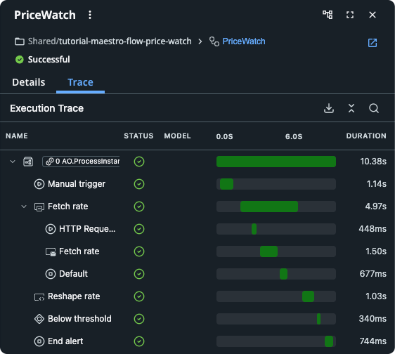

Follow these steps to start an instance of the deployed Flow as a job, watch it complete, and then verify the output:
Use the
Start jobbutton for ourtutorial-maestro-flow-price-watchdeployment. -
Use
Startbutton to start the job - the input values will already be set to the default values ofUSD,EUR, and0.9. -
Verify the output values for
watchResultwhen "✅ Successful" shows the job has completed. -
Open the
Tracetab to view each of the steps and the time each step took to execute.
Congratulations! You've completed your first Maestro Flow by building, testing, deploying, and then running it! Before you close this page, make sure to follow the last step to clean up the resources we deployed in this tutorial.
