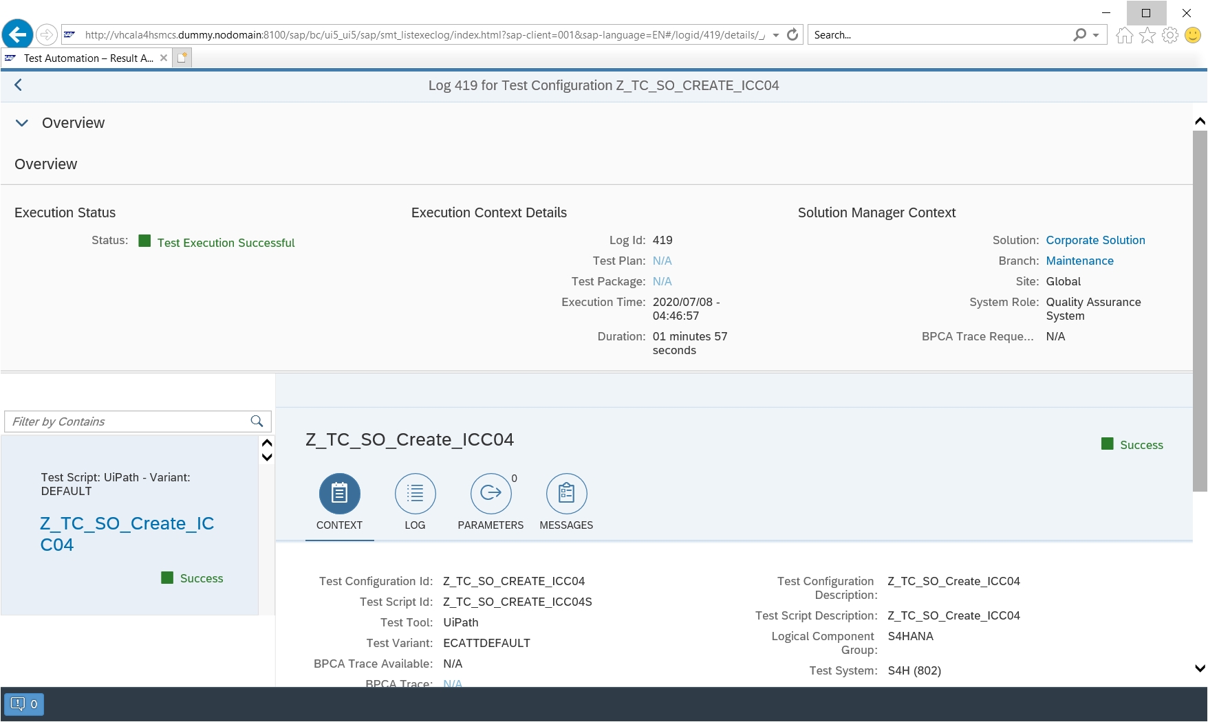

Viewing the Execution Results
Once the execution is completed. The results are available in the SAP Fiori User interface within SAP Solution Manager.
  1. Start SAP Fiori Launchpad.
  2. Navigate to Log > TestTool Log.
  3. Review all execution details in SAP WinGUI. Alternatively, you can click the link right next to the UNCPathToLocalLog entry to view the results in the Test Manager. For more information, see Analyzing Test Results.
