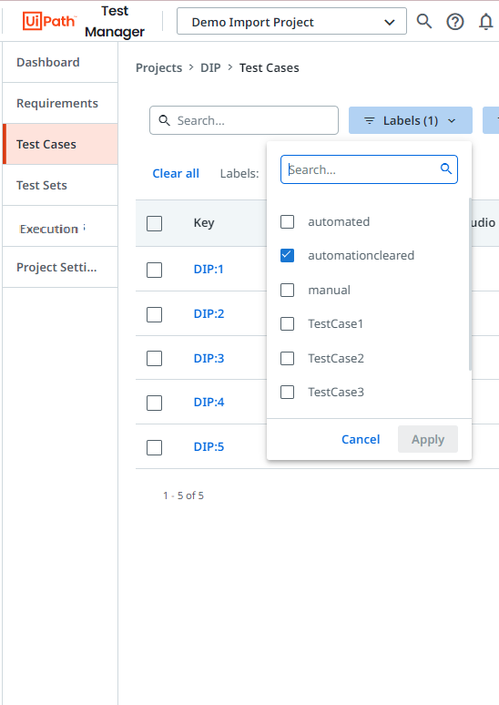

Viewing automation information
To view information about the automation that generated a specific test case:
  1. In the Import project page, select Include automation information for test cases at the bottom.
  2. Finish the import, and filter through the imported test cases, applying the automationcleared label filter.
  3. Open every returned test case, and go to the Details tab to retrieve the information about the automation that generated the test case.
    Figure 1. The Labels dropdown list displaying the automationcleared label
The automation information displayed in the Details tab includes:
  • AutomationId
  • AutomationProjectName
  • AutomationTestCaseName
