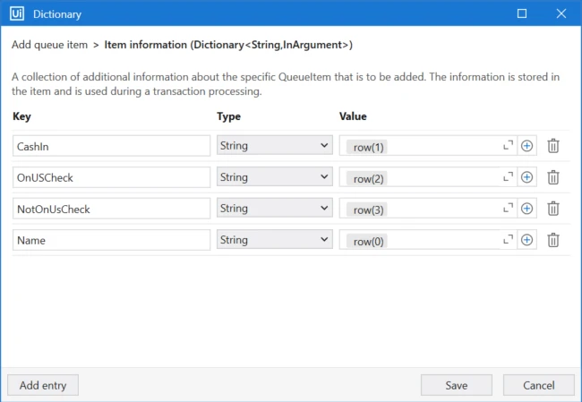

  10. Click the field under Item information to open the Dictionary Builder window. Create 4 arguments, each corresponding to a column from the report. Define them as follows:
    • Name, keeping the default values for Direction and Type, and with Value set to row(0).ToString. This retrieves the value from the column with the counter 0 for each row in the workbook, in our case the name of the client.
    • CashIn, keeping the default values for Direction and Type, and with Value set to row(1).ToString. This retrieves the value from the column with the counter 1 for each row in the workbook, in our case the Cash In value.
    • OnUsCheck, keeping the default values for Direction and Type, and with Value set to row(2).ToString. This retrieves the value from the column with the counter 2 for each row in the workbook, in our case the On-Us Check value.
    • NotOnUsCheck, keeping the default values for Direction and Type, and with Value set to row(3).ToString. This retrieves the value from the column with the counter 3 for each row in the workbook, in our case the Not On-Us Check value.
  11. The Dictionary Builder window should look similar to the following screenshot:

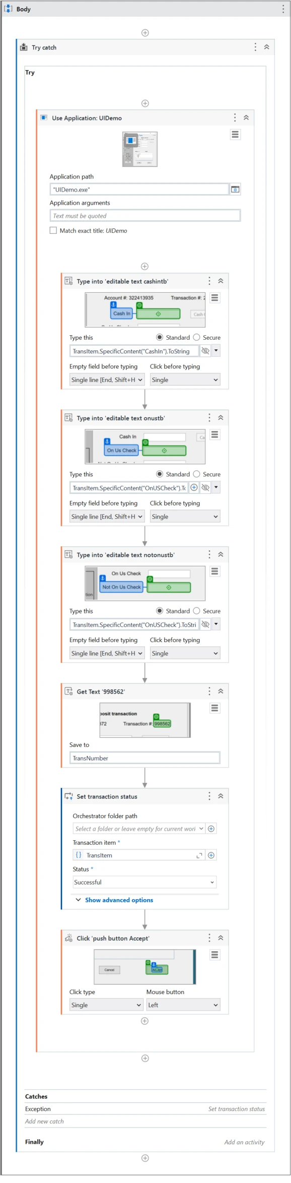

  23. Perform the following series of activities for each of the Cash In, On Us Check and Not On Us Check fields in the UIDemo application:
    • Into the previous Try Catch activity, add an Use Application/Browser activity to open the application.
    • Add a Type Into activity.
    • Click Indicate target on screen and select from the UIDemo interface the blank field corresponding to Cash In.
    • In the Type this field, type transItem.SpecificContent("CashIn").ToString. Each term in the expression is explained above (step 15). This expression converts the value in each QueueItem variable into a string variable.
  24. Add a Get Text activity after the previous Type Into activities and select "Indicate target on screen" from the options menu.
  25. Point at the transaction number in the UIDemo application and click Confirm.
  26. Set the Text field to a new variable, say TransNumber. This retrieves the transaction number for each queue item that meets the initial condition.
  27. Add a Set transaction status activity after the Get Text activity.
  28. Make sure the Status field is set to Successful and the ErrorType is set to Application. This way, if the set of values is successfully introduced in the application, the status of the transaction is set to Successful, or else labeled as an application exception.
  29. In the Output window, define a new argument and add the previously created variable, TransNumber (step 25) as value.
  30. In the Transaction item field, add the TransItem variable.
  31. Add a Click activity after the Set transaction status activity.
  32. Click Indicate target on screen and select the Accept button from the UIDemo interface.
  33. The Try Catch activity should look similar to the following screenshot:

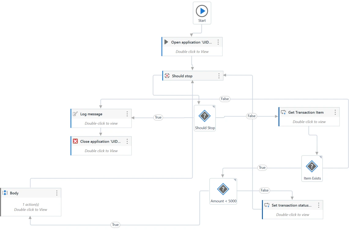

  34. Return to the flowchart and connect the previous Sequence activity (step 21) to the Should Stop activity (step 6) to create a loop and process the next transaction in the queue.
  35. The flowchart should look similar to the following screenshot:
