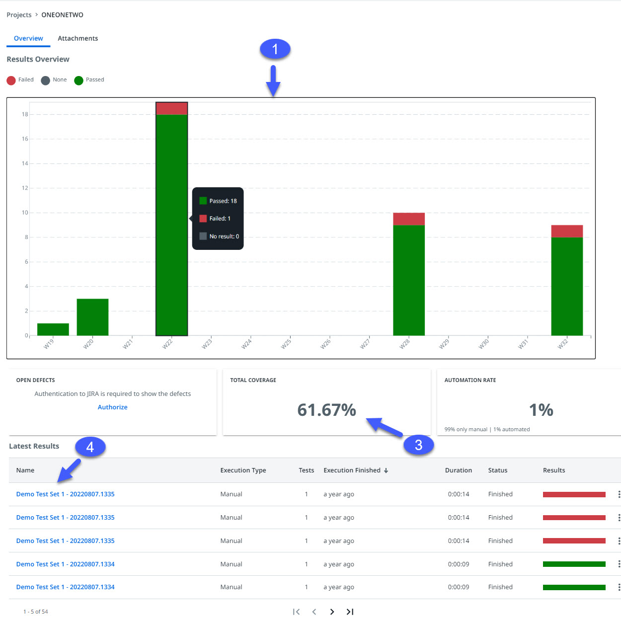

Understanding Dashboard Reports
You can examine the reports of each project individually. To view dashboard reports, open Test Manager and select a project from the list to view the Dashboard page.
Section Number
Report
Description
1
Results
Bar chart displaying the results of your test runs. To switch between daily and weekly views, click the focus indicator, at the upper-right side of the dashboard and choose an option from the dropdown.
The weekly report goes back 14 weeks.
2
Current Day/Week Indicator
Day/Week indicator of the results shown in the bar chart.
This section is not captured in the above figure.
3
KPIs
Open Defects is available only for connected projects. For example, defect reporting from the Jira project connected to Test Manager. The number of defects defined with the highest priority in Jira are shown in the Critical section. You can click the hyperlink to open the Jira filter.
If you unlink a connection, Open Defect will not be shown anymore.
Total Coverage
The percentage of requirements that have at least one test case out of the total number of requirements.
Automation Rate
The percentage of test cases without automation/manual steps defined, as well as the automated, and manual test cases, respectively.
4
Latest Results
Latest test executions that contributed to your test results displayed in the bar chart.
